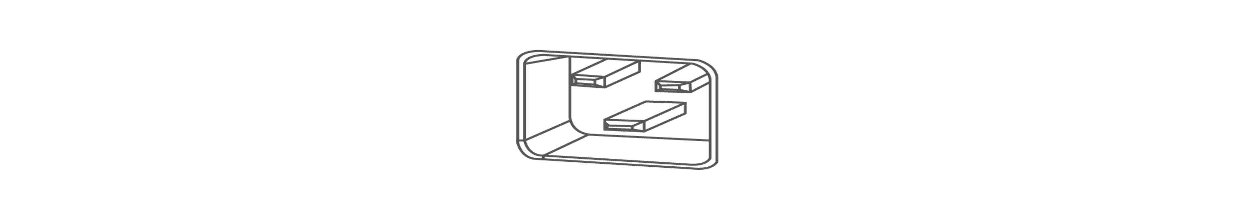

There is a standard IEC plug at the end of the control box’s main cable.
Connect a local dedicated main outlet or cable to the IEC plug. The control box is powered by 100V-240V AC (the input frequency is 47-63HZ) and its internal switching power supply converts 100V-240V AC into 12V, 48V DC, which supplies power to the load of the control box and the robotic arm.
Therefore, it is necessary to check whether the connection between the robotic arm and the control box is secured before use. The hardware protection and software protection of the control box can ensure the safety of use largely. The emergency stop button of the control box allows the user to cut off the power of the robotic arm in the shortest time possible and protect the safety of both personnel and the equipment.
To power on the robotic arm, the control box must be connected to the power supply. In this process, the corresponding IEC C19 wire must be used.
Connect to the standard IEC C20 plug of the Control Box to complete the process, see the figure below.

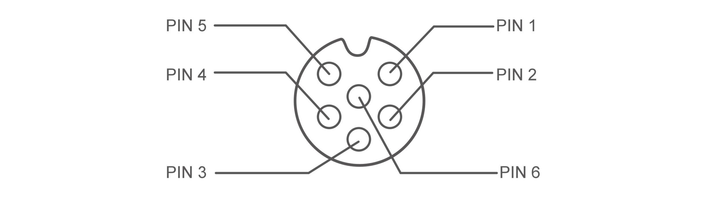

3.2.3 Definition of Industrial Connector
Power and Signal Cable:
| 6-Pin Industrial Connector | |||
| 1 | GND | 4 | GND |
| 2 | RS485-A Arm | 5 | RS485-A Tool |
| 3 | RS485-B Arm | 6 | RS485-B Tool |

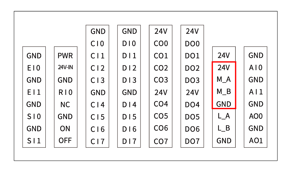

3.4 Controller Electrical IO
This chapter explains how to connect devices to the electrical I/O outside of the control box.
The I/Os are extremely flexible and can be used in many different devices, including pneumatic relays, PLCs, and emergency stop buttons.
The figure below shows the electrical interface layout inside the control box.

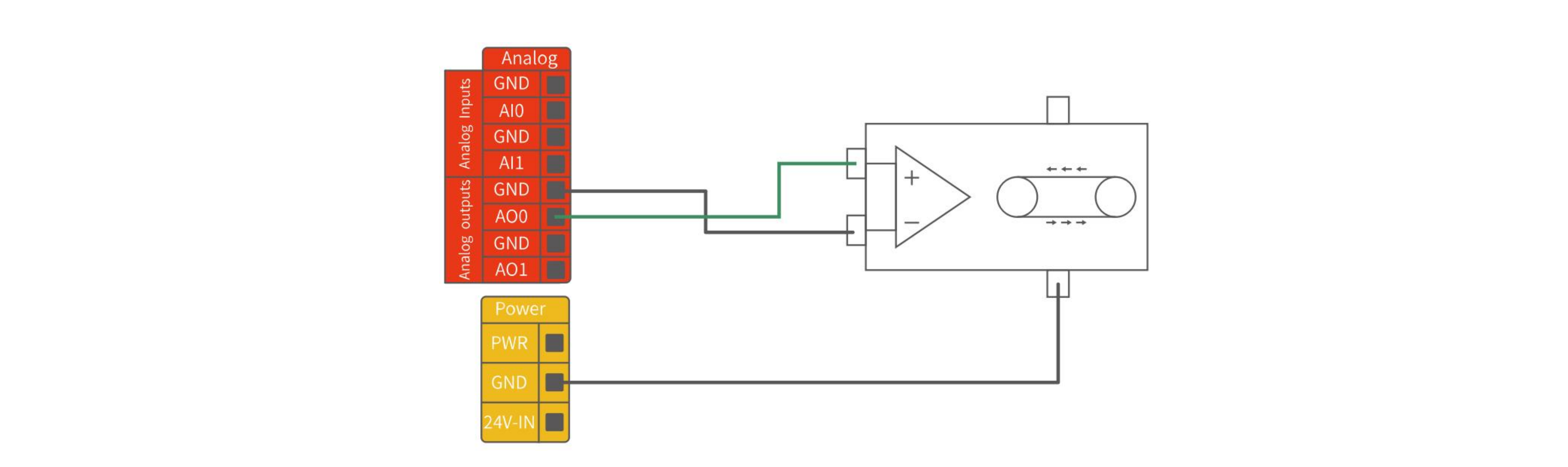

3.4.3.2 Analog Output
The following example shows how to use the analog speed control input to control the conveyor belt(Connect to AO0 or AO1).
3.4.4 Controller RS485
The Controller IO provide an RS485 interface, use can communicate it with third-party devices that supports RS485.
The id of our controller is 10.
PIN Connection:
- M_A (RS485-A)
- M_B (RS485-B)
- 24v
- GND
NOTE
- L_A and L_B are reserved, without functional for now.
- When using M_A and M_B, the robotic arm can only be considered as a master.
